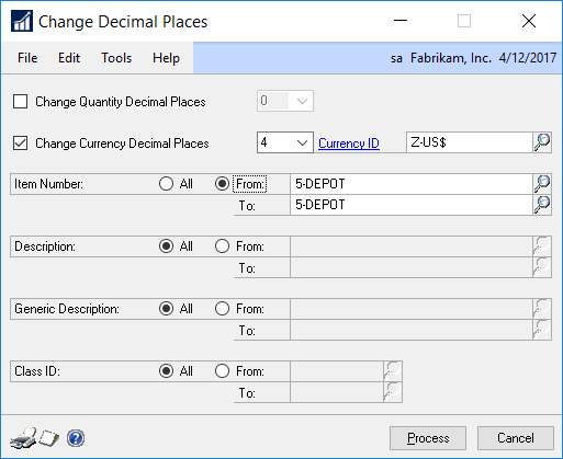

printer.jpgFirst, there is a utility in inventory that you will run.  Then, if the Manufacturing module is used, additional steps will need to be taken. Before performing any of the steps in this article, it is highly recommended that a backup of the company database is saved in case any unexpected changes are made.
To run the inventory utility, navigate to Inventory - Utilities - Change Decimal Places.  Select the Change Currency Decimal Places checkbox and the number of decimal places that you now want.  Additionally, you can change the decimal places for a range of items, descriptions, generic descriptions, or class IDs.
Once the box to “Change Currency Decimal Places” is checked, the user will receive the following message.
This prompt will only pertain to those items in which you will be decreasing the number of decimal places.  If you are increasing the number of decimal places, zeros are added for all amounts on the documents where the item is being used except for the Dynamics GP Manufacturing module.
